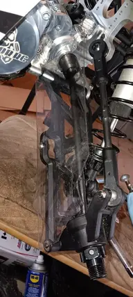

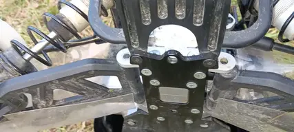

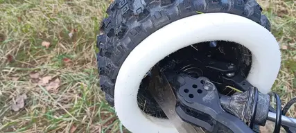

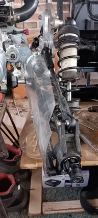

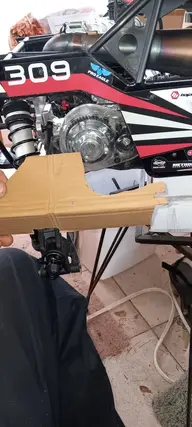

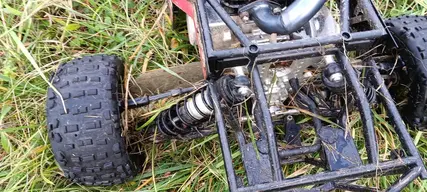

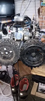

Having a hard time to get runtime on the break in, second run my header studs came loose and one fell out, and the dog bones wrapped up so much grass on them they where binding the truck. Did this a long time ago on some rc's, and after I saw the pathetic tiny cv guards I got for my 5t I decided to go back to old habits and made some shields out of a sheet of lexan. Started with cardboard to get the fit then copied it onto the lexan sheet. Right side with the gear cover needed alot of the shield to be cut for clearance, so instead I heated with the heat gun and molded it slightly
