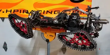

Righteous ?I did something similar. Here, mine. A bit more ghetto but it works well?

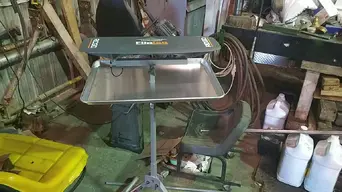

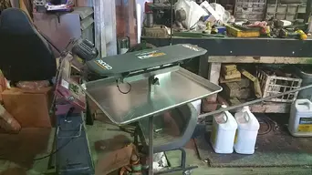

I've seen that a HD for like $32.00 how's that working out?I didn’t build it but I’ll be modifying it. I will be adding a tray someday
The black material is round baler belting, the top was made to rotate by cutting the square pipe, welding in a long 1/2 bolt with head cut off, slide a 1/2 flat washer down bolt until it rests on the tube and tack weld making sure it's straight with bolt shank,take 2, 1/2 copper pipe sweat unions slide them down the bolt ending up about 3 inches apart with one just above washer, I jbwelded them to the bolt. Sand the out side of the unions down until the upper portion of the pipe slides over the copper unions like bushings. I drilled a hole just below the cross bar and welded a 1/4 nut and installed a thumbs thumbscrew for a rotation lock.Very nice! Can you tell us how you made the platform “rotatable”? Also what is the black honeycomb material? Thanks!

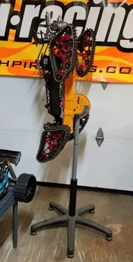

I have one of them. If they were still available I’d buy a few more.Here is my version of a rigid stand. Top rotates and locks, and you can adjust height of tray. Tray comes off to store stand, I need to get the second stand built for the 5ive type chassis.
