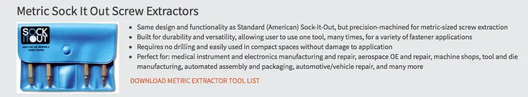

I recently came across a product called Sock It Out, they are bits that don't require any drilling, you just tap them into the rounded out screw head and put a wrench on them and turn counter clockwise. They sell them at McMaster-Carr. I will let you know if they work down the road.Dear Members,
