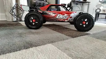

I would not use stock wheels or tires. They are not that great and heavy for the size .
I am running max5 with 17T and the stock tires were constantly spinning on any surface.
Just got the proline MX57. they look and fit great. Traction is much much better and the are lighter then stock wheel/tire setup.

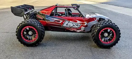

I do not have that car anymore. I have another one with max4 combo that I am running. Badlands mx43.This looks good...As I posted in another thread, I'm also looking for tires for myself. How are those still working for you do you still recommend?
I saw another YT video where some put the Masher X HP BELTED F/R 5.7” by Proline.
Blessed to have two! Nice...bead locks look good never used them before. I assume those are DGI 1" extenders?I do not have that car anymore. I have another one with max4 combo that I am running. Badlands mx43.
ThxThey are ATOP from Amazon. I used them all the time. Better quality than the dgi ones.
How well do the MX43s handle 12S?I do not have that car anymore. I have another one with max4 combo that I am running. Badlands mx43.
Yes, but the wheel is plastic, so an 18mm step drill bit solves that problem real quick.Crazy to see a 2 year old thread resurrected, lol. But curious - I thought the Badlands MX43's are X-maxx tires? They have smaller axle diameter than the DBXL, don't they?
